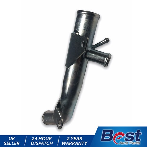

Following on from the service and timing belt change, my garage had spotted a steel water cooling pipe running from the oil cooler had pink residue on it (antifreeze) suggesting a leak. They had ordered in a replacement and fitted it for free today. It helps that the owner is a motorhomer. They say they have replaced a few of these pipes on Fiats. My van is a 2015 2.3L multijet. Perhaps worth a look next time you are lying under your van, (as you do). It is easy to spot.
This is the type and shape of the pipe. The leaks seem to be at the joint of the smaller pipe (not the very small one) on the left
