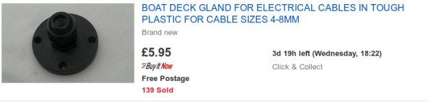

Best way to bring cables in is under the panel using a marine gland, miles better than the daft units sold on ebay.deck g a.png
