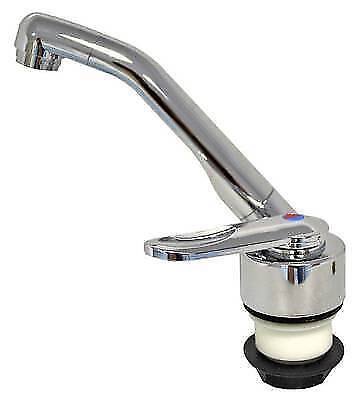

flushing out fresh water tank yesterday I noticed some damp on the floor next to the shower cubicle. Further investigation located a drip from under the mixer tap on the pop up basin. Looks like the cartridge is leaking
Its a comet florenz tap and I have found a new cartridge on line but it looks like the cartridge might need to come out from below, not lifted out with the tap in situ.
Has anyone changed the cartridge on one of these?
We are off tomorrow for a couple of weeks so I will be switching the water pump off at the main panel when not using the taps as it obviously only leaks under pressure.
